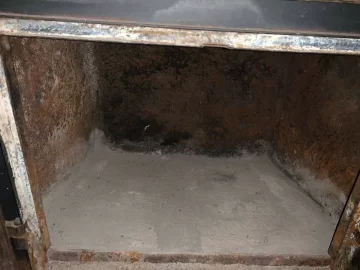

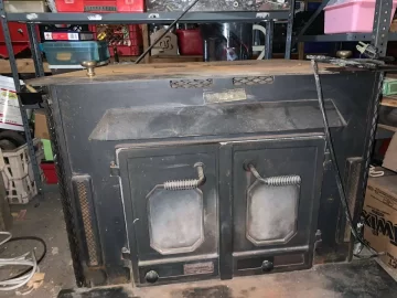

Going to look at a 27000 today with intent to purchase. It's a triple wall. Any tips on what to look out for/red flags etc. Thanks in advance
Cracks, discoloration on the outside (over fire), how much rust. Stick your head in the firebox and use a flashlight. And take your time.
[Hearth.com] Buck 27000 advice
Inside an old stove you can find rust. If it is surface rust, easy to remove, it might be okay. But I would be careful. How much are they asking? How old is the stove? Where are you planning to install it?
