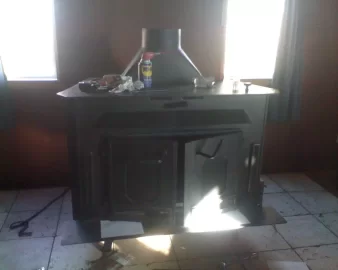

anyway.. I got my gaskets at MENARDS rope style... yes aroun the sides and top.. also redid the flat gasket back side on motor housing OH also rope gasket on the flue stack'''''you can kinda see it in the pic!!!!

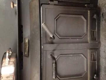

Hey wasp. Need help!! Replaced gasket and can only get latch to go this far and I don't want to break it. This normal? I know it should be tight. I cleaned channel GOOD and even stretched gasket as I put it in. Help me please soon as u can. My furnace won't quit turning on!! Lol. HATE IT!!

lol shoot the furnace... looks like the gasket is big.. squeeze it down... mine was tight too for a while
