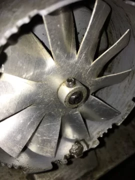

If this is an older buck the fan is on the back of the insert:
[Hearth.com] Buck fan sounds like it's going to break through the wall!
You can buy the parts direct from Buck: (broken link removed to https://www.buckstove.com/partsstore/home.php)
You will need to find out which model you have, here is a thread to tell you how to identify your model: https://www.hearth.com/talk/threads/old-buck-stove-information-one-stop-resource.125611/
Reactions: Woody harrelson
Yep, Some Bucks have a motor with a shaft sticking out both ends, My Old Stove (Model 27000) only had the shaft sticking out one side. It originally had the 9 blade fan, Once when I replaced the motor I bought the 5 Blade, Mistake, Had to pull it again and swap the 9 blade back on... You may have to scoot it out and see what's up..
