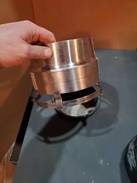

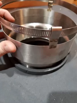

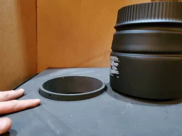

Hi,
I recently purchased a buck stove model 21 and im going to use it as an insert for my fireplace and will be connecting to to stainless flue liner but I'm a little confused on how to connect it to the liner. Do I just use a single wall starter pipe or double wall starter? I attached some pictures of what i believe is correct but want to make sure since ot doesn't really seem right and im new to this. Any help would be appreciated! TIA

You would use an appliance adapter made for the liner you are going to be using.

Wouldn't i want it to go around the outside vs the inside so that way there's no play or it will be fine? Thank you!

It should fit inside the stove collar and the liner inside the adapter

Okay thank you for the help. I wasn't sure an was thinking that you always want the stove to go into the liner and not the liner into the stove. Thank you again for the help!

Nope male end always points down
