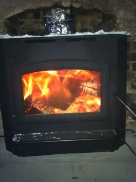

    Pic of a half load of silver maple a few minutes after closing it down to 3/4 closed from 1/2.

  5. brian89gp

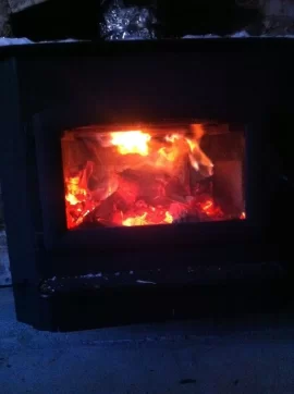

    7/8 closed. 20 minutes after the last pic, and about 1 hour after putting the wood in.

  6. brian89gp
    brian89gp
    Mar 15, 2008
    505
    99
    Kansas City
    7/8 closed seems to keep a nice coal bed going. Will try that tonight.
    I picked up a magnetic stove thermostat, where on the stove can I put it and what temp ranges am I looking for? The liner is stainless and also insulated so I can't really stick it to where the instructions say to put it.
    The draft is quite strong on this one, I am finding it almost impossible to even get a hint of smoke smell into the house when opening the door. Got to be quick about it with the door open though as a mini inferno kicks up within a minute or so.
