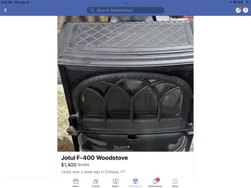

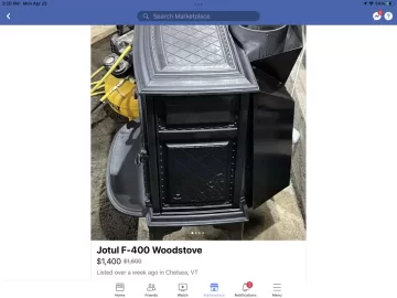

I did find this one but it’s a 2004…. $1400. Thoughts please?One has to decide if the stove is for show or for go at some point. If the stove is being used for 24/7 heat then one that burns for a longer time would be my preference, but that may not be the case here. The Jotul F400 is no longer sold in America, but it would have fit this requirement. If you can find one in excellent condition then I think you would be happy with it.

As an F400 enamel ivory owner that price might be high but. What’s 600$ Overpriced compared to a new stove if it’s good shape. I drove 3 hours to look at one only to find it was left on the rain an needed repainted and he wouldn’t budge on the 1000$ price so I passed. Go look at it and see if it’s in good shape.I did find this one but it’s a 2004…. $1400. Thoughts please?

It’s not an all night burning stove and there have been times when I could only reload with two wires shaped but not huge splits. It fit my space really well and I’m happy with it. It’s a well built and serviceable stove but you might be buying a project. I’m kinda kicking myself for not and painting it blue but… last think need is another project to lay around half finished. I went with a Drolet.
Just my thoughts.
