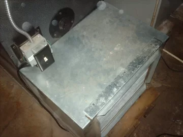

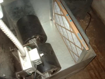

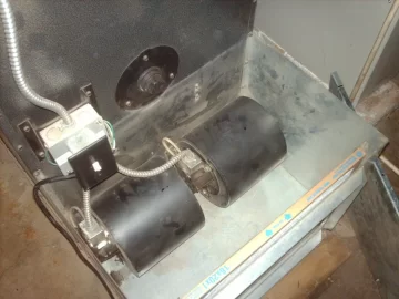

I THINK he's saying the return blower is a bad idea. Heres some pictures of my filter box, its not connected to anything, just draws air in from the basement. I have some vents under the 1st floor stairs that allows it to draw some return air from the main floor and help circulate it around.

so you want to pull air from the house ? should be pretty straight forward, just fab some duct work off the box when you build it and over the 3 ft and into the house. As to size and all i'd keep it the same size as the fliter box opening, which on mine is 16x20.
