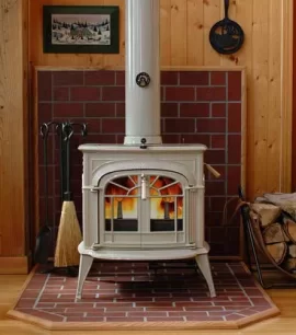

Fossil: I'm envisioning wood around the perimeter of the floor material, as pictured here

The term 'surround' is a little confusing. You are building a hearth. I changed the title to clarify.
Yeah, that's cool...the terrm surround led me to picture something like wood trim around the front of the fireplace opening or something. Couldn't make sense of it.
