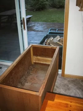

I had one in my last house, and have a different system now. I like my new system much better. Here's the scoop:
PASS THROUGH SYSTEM
There was a built in "chest" right by the fireplace. The outside wall of the chest had a small door, that was built just like a regular outside door. It was solid, and had a deadbolt lock for security. I think it was even hooked up to the alarm.
I would bring the wood to the door, then kneel down and reach in and put it inside. Problem was that I'm kneeling down and reaching in and arranging the wood. Not convenient.
NEW SYSTEM: SLIDING WOOD BOX
My new system in my current house is 100 times better. I have a custom-built chest with teflon furniture sliders on its feet. I slide it to the sliding glass door, fill it with wood and slide it back next to the fireplace. I first built it with casters, but the sliders are much much easier.
  • [Hearth.com] Building a pass-through for firewood
