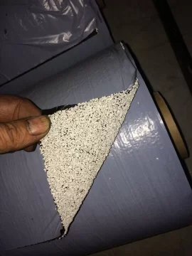

Got some PolyGlass today to go on top of the Grace I&W to protect the grace before the deck boards go on.
Is that a good idea?
see pics

Hello
Polyglass is on over the 2 layers of grace I&W ! ! ! The light color pebble top on the Polyglass will not be harmed by UV rays and will reflect the heat. The Polyglass is tough stuff to cut!
The Polyglass interlocks with a tab with the same special adhesive that Grace has. Grace goes up 14 inches against the house under the shingles.
Some builders do a floating deck, but this is not floating, the joists are bolted into the 2x12s below the roof so it is stronger than a floating deck! The 2x12s below are tied to a ledger bolted to the house!
See pics below. Click to Enlarge
