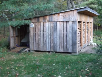

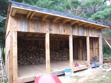

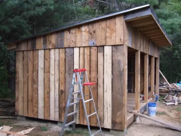

I did a 12 x 20 woodshed . . . although when you figure in the 2 x 4 wall construction it is obviously a bit smaller than those dimensions. Back of the shed to the bottom stringer of the roof is 8 feet. Front of the shed to the bottom stringer is 9 feet 6 inches . . . so only a 1 1/2 foot pitch. It's not much and I don't have a metal roof which would allow a lot of snow to slide off it . . . instead it accumulates there until it melts or I rake it off. That said, I think I over engineered this woodshed so it will take a lot of weight -- both from the weight of the wood on the floor and the weight of snow on the roof.
Personal opinion . . . depending on the construction . . . I think a 1 foot drop might work . . . but going with a bit steeper pitch would work much better.
Pics show my original woodshed before it was filled . . . front and side . . . and the later addition my brother in law and I added for his two sleds.

How wide are the gaps between the boards? I assume that's for wind/air access to keep it breezy?
About 3/4 of an inch ... and yes ... the gap is to allow the wood to continue to receive the benefit of the wind although to be fair it is seasoned for at least a year previously and when the shed is fully loaded only the exterior stacks are getting much of the wind.
