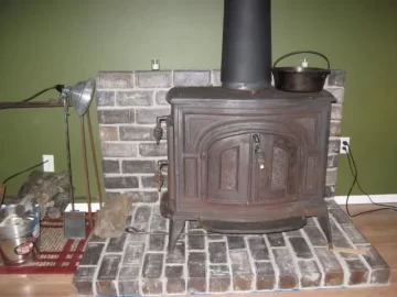

I used 100+ yr old brick pavers and plan to extend the hearth L and R to complete the wall and go up the walls on both sides to have complete ends. I will also build in short walls extending out from the back wall closer to the stove on both sides to provide wood storage and extend the middle stove section another 10" forward on a curve for the new stove that loads from the front.
I cut down to the subfloor(which I recomend) and used durarock screwed to the floor. Grout on that for the bricks to sit on. If you need more height you could double up the durarock or use plywood under it. Also, grouting the durarock to the floor would be an easy way to level the hearth. Lay the grout out even and use screw tention to pull one side deeper into it than the other when screwing it down.
Here is a pic of what I have so far. Note, it is temporary in regards to a finished product so that I could legally and safely burn this winter with my old school stove. I have more bricks to finish the complete hearth in the spring and a new stove coming(most likely a E-30)
