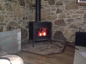

I did both of my hearths, and many others. My family room hearth usually confuses people. When I first posted it on here everyone blew me up thinking it was wood...
  • [Hearth.com] Building hearth pad

is that slate tile?? that looks really good
Is just ceramic tile. I prefure to have the hearth same level as floor that way no toe stubbers when loading stove. Also you can have wood bucket or stove tools beside stove. Half on floor and hearth if need be
