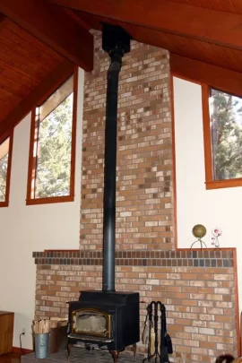

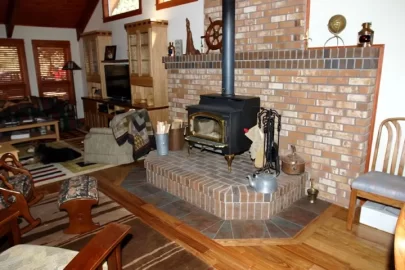

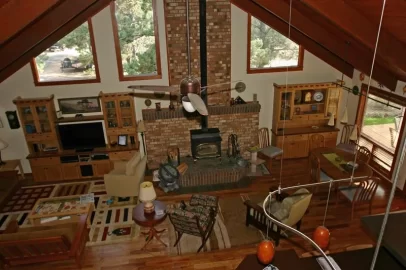

    ~2600 ft², lofted 2nd floor, central forced air electric furnace, Lopi Liberty. Ceiling fan(s) an absolute must, or all your heated air will just stratify way up above where you are. Great Room & lofted upstairs (3 rooms) are no problem to heat at all. Downstairs rooms remote from the Great Room are the challenge, but clever use of fans can make it all work. Rick
