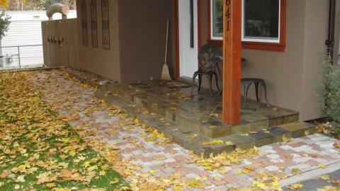

I can't see how you'd have any problem with slate around a hearth. My understanding of slate is that their weakness is moisture, not heat. They are not recommended for outdoor applications where they are constantly exposed to the elements. Despite that I went ahead and put slate tiles on my front step. It is covered by a roof, but the rain and snow does get on there when the wind blows. I sealed the grout and tiles with concrete sealer to help protect against water infiltration, and so far they seems to be holding up, but time will tell.
One potential problem I found when installing the slate tiles was that some of the tiles had weakly bonded layers. When you look at the tiles on edge you'll often see that the tile is made up up layers of rock, and I found a few tiles that you could actually pry apart the layers and split the tile in to two pieces. I actually realized this after I had already mortared the tiles in place. I decided to correct the problem before I grouted the tiles and what I did was to pry the loose layers off the problem tiles and glued them back into place. As I said so far they seem to be holding up fine.
I thought maybe this delaminating of my slate tile layers was related to cheap tiles, but I have since inspected many expensive slate tiles in other flooring stores and found the same problem in a few tiles everywhere I have looked. Just something to keep in mind for future slate projects.
