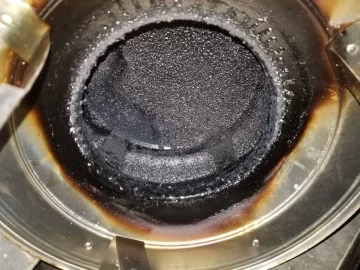

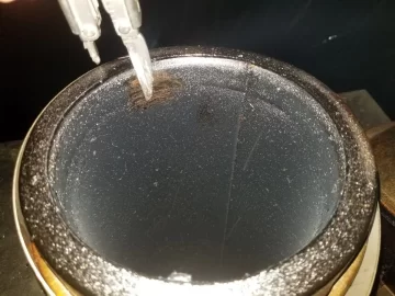

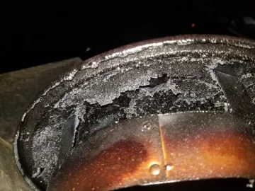

Flame Monaco ZC fireplace. These are pics after burning 1 face cord of oak @ <10% and Maple around 20% in the last 2 weeks. My concern is their is no way to access the roof in the winter to clean the chimney. Unit seems to be burning properly with nice rolling secondaries. Chimney is 18' tall. Any suggestions???

Looks like too cool running. That can be common in milder weather. How is the wood moisture being checked? Have you placed a 2" stove thermometer on the stove body yet?

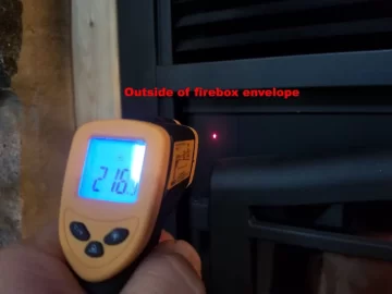

Still using my laser heat gun. Nobody sells anything smaller than 2 1/2" Called a half dozen places and searched all over online. The mag mount is not accurate i'm sure but it is my only point of reference other than the laser gun.

Bottom up cleaning is a great idea, also it was hard to tell but the one pic looks like the cap, if theres a screen on the cap you may want to remove it because that can get clogged up and it would be hard for a brush to clean it out from the ground, maybe a soot eater is on order for this application. As BG suggested the best bet is to burn hotter, hopefully things improve as it gets colder out

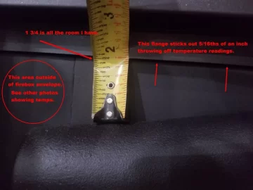

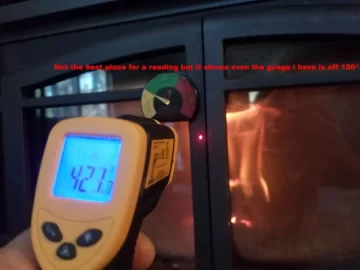

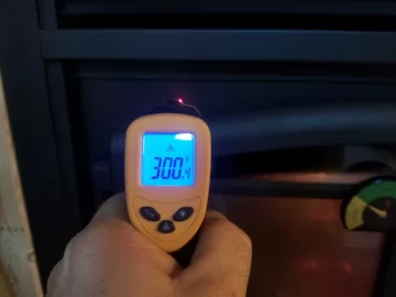

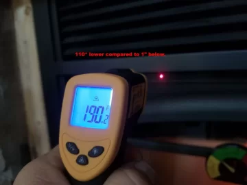

Begreen,
I would need something 1 3/4 or smaller. The flange across the top allows air behind making temps off 100* plus or minus. The area on either end would fit a 2.5" but is outside of the envelope of the firebox. Check these photos out for a better understanding......

I'm pretty sure that those magnetic thermometers are calibrated for their intended usage scenario. This means that they won't indicated correctly in other scenarios, like if you stick them in the oven (probably read high since it assumes part of the thermometer is in the room not saturated with the same temperature). I think the opposite is true to where your thermometer might be fooled by reading off the small metallic surface area or the radiant heat coming thru the glass.

Visually, it looks like the fireplace is being run a bit cool. Not sure why. Maybe too small fires, maybe not perfectly seasoned wood? You'll know better with the first chimney cleaning. Have a professional sweep do it while you are there and request a full report

shiny, and liquidy creosote comes from either burning to cool or wet wood and often a combination of both.
You can't be doing everything right and getting buildup like that on your cap. Something is off.
I burned a lot in milder temps last year and had more build up than ever before when I swept the chimney. I probably burned 4 cords and had a good amount of goo at the very top of the chimney (about 35 feet of chimney total). I also burned plenty that was mid twenties moisture content so I can attest to the truth of what squisher says above. If you don't have access to the roof it's probably worth looking into a soot eater if that will work with your set up. Soot eater will not work with my set up unfortunately, so I just sweep twice a year.
