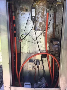

Here is a shot of the outside of the OWB and the inside of the service cabinet.

That looks like a stainless Taco 009 pump, it shouldn't rust. You can take it off by loosening the flange bolts or the screws on the motor, but I would just circulate it and see if you're getting flow. I think the Hardy stoves have to be over about 120 and the thermostat then calls for heat to start the pump.
If the stove is hot a little rain down the chimney won't hurt a thing. Cover it during the summer. Hardy is not an efficient model so be prepared to have a fair amount of wood on hand. I've seen flame out the top on those units.
Not meant as criticism, just saying it's old school.
E Yoder; you're right about the pump. I have a feeling that this OWB has not had any love in a very long time so I'm planning on pulling the pump just to check everything including the impeller. The stack has been uncovered as long as I can remember and I'm trying to find something large enough to cover the pipe now.
