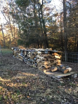

Also, we finished stacking the firewood that we've had down for almost two months. Today was a very good day and the dry weather allowed us to drive up to the pallets for stacking the already split wood. Here's a picture of the finished stack...we have lots more wind-fall to collect that will be much better seasoned. I feel very good about having this part completed...We prolly have this much more available around the farm to gather and split/stack.
Makes me feel all "warm" both inside and out to stand on the deck and see this resource ready. Hahahaha!
