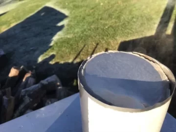

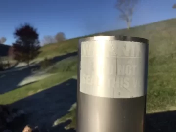

Here is a picture of the pipe over the water tank

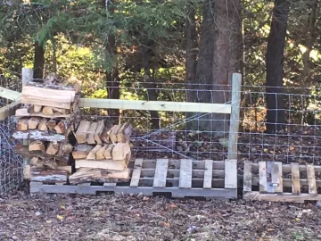

No I have to get my wood off the ground and stacked. I have almost a full cord cut and the pallets have been placed for stacking.
Finally, stacks that we've had on the ground for months are being moved into better storage. We've had many reasons why these stacks haven't been moved into place but those reasons have been resolved and we're setting things right.
  • [Hearth.com] Bunk House with Hardy H2
Hard to tell with the leaves in the pic, but if you can and haven't, try to get the pallets up off the ground on blocks. The higher the better. I use concrete blocks. Splits would be better than nothing, you can rotate them out for fresh ones and burn them, every time you empty your pallets.
Reactions: SpaceBus
I like to use rounds with punk or otherwise undesirable features and then just let them rot into the ground. I have two winters on some of them.
Reactions: LiamFitzpatrick
maple1, I have leveled the pallets on both blocks and splits. I'd expect them to degrade (rot) and I'd prolly burn them when we get to the bottom of the stacks and replace them when we resupply. Thanx for the advice. I love the wealth of experience that's available here and appreciate that y'all are so helpful. Liam

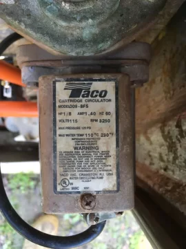

What model pump is that one? That price seems high. I'm trying to understand what you were taking apart when it started leaking?

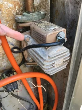

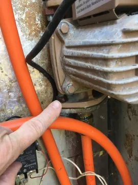

Here are some pictures of the pump, installed, including the model number. I'll pull the pump later today and try to get some pictures of the bent flange as well as the area that I think the leak is coming from...
I have pointed out two of the four 7/16" bolts that I remove to unmount the pump.
