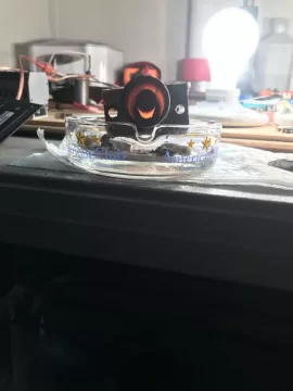

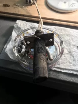

Geez I guess hoping for quality is lost cause now the ignitor just went. Got it the same time I got the pot...

Bummer.Iwould still buy a big e for my sisters.bil's leaky cabin,good stove for large area.BTY,St croix's ate iginters,for years,harman went through a big bad batch,it happens.

Yours like this one
