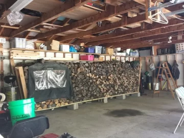

noce storage area--how much wood is in that picture?
