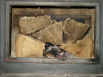

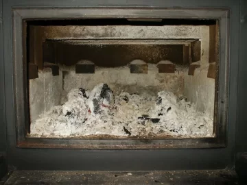

Loaded my Grandma Bear just before 10pm lst night, fired it up to about 500 deg. Shut it down at 10:15. Had a good bit of coals left this morning at 8:15.

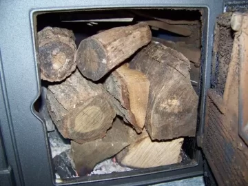

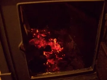

Here's a couple pics after a 12 hour burn and fresh reload of Oak. I like to rake the coals forward then stuff a couple bigger splits in back and fill in from there. This little box can be a jigsaw puzzle when loading so it's good to have some smaller splits or rounds for fillers.
