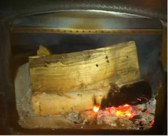

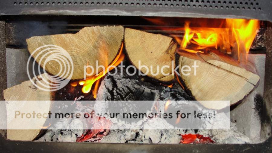

Here's a typical burn for me.
Stove- Regency F2400, Chimney- 20 ft 6"SS, Wood- Lodgepole pine.
Loaded up for the night (note wood is loaded North/South)
[Hearth.com] Burn times idea for overnight burns
(broken image removed)

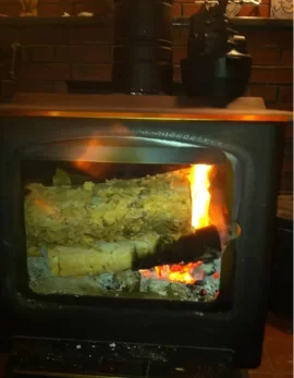

The temperature continued to rise to about 600 F after the wood was loaded, then the draft was closed completely and time shot was taken before going to bed.
The night time temp outside was around 30 F (-1 C)
Gone to sleep ZZZZZZZZZZZZzzzzzzzzzz

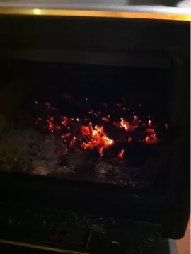

Next morning
Temperature in the stove room was over 80 F

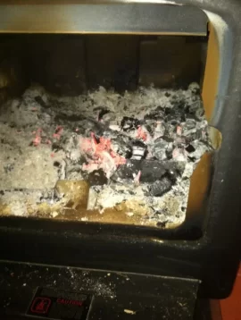

Lots of coals to start another fire, but house was plenty warm so we just open the draft and let the coals burn out.
This was a typical overnight burn, if I wanted a longer burn I would let the initial fire burn hotter and more completely, then rake the coals forward and load the wood East/West. That will often give me another 2-3 hours till I need to reload, using the same wood.

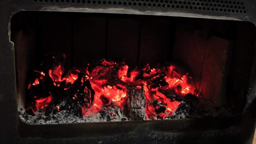

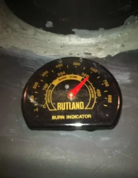

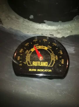

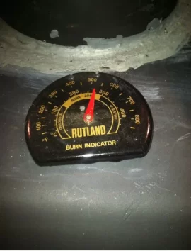

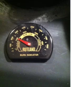

As promised earlier, i came home and did a reload on coals from earlier this am. The stove was about 250 and some coals left from a load of maple and locust. Just loaded the stove with the same thing now plus a few small splits of birch. It got pretty warm pretty fast. I was chocking the air down as needed. Right now she is cruising at 600. Last picture should have been first on the order but yall get the idea.
Morning Follow up
Woke up this morning at 6:30 and the stove top was still at 375-400 and had a nice bed of coals and some solids forwards the back wall of the stove, that locust sure does burn nicely. Loaded the stove again and took right off. Off to the races at 650 in no time. by the way its 3 degrees out and 75 around the house. both stoves going.
