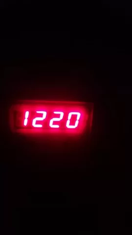

I got a a stove that when fully loaded will get 12 hr burns. but right now im burning small fires. right now I have enough wood in it to get the cat going. I put in a couple of medium splits and will let it burn out as its not cold enough to burn long periods of time. even though i have a minimum amount of wood my cat is still 1220 degrees.. As long as you can get it up to temp you can put a minimum amount of wood in and turn it down and still burn clean. Im just about to turn my air all the way back
