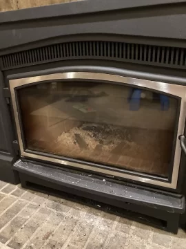

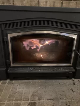

Your glass should not look like that, with clean burns.
Is that you air control under the ash lip of the Osburn?
So what exactly is happening if your glass looks like that? I got my Neo2.5 installed this summer and have been burning some fires here and there the last couple of weeks and my glass does this sometimes. Its a brown dusty residue not some black tar and wipes off pretty easy. Is it usually an air control issue. Im new to wood burning so Im still learning and experimenting. I understand there are all kinds of variables to this. Door seal is tight and wood is dry.Your glass should not look like that, with clean burns.
its an indication of your smoldering you wood some.. aka.. your turning back the aire before the wood gassed offSo what exactly is happening if your glass looks like that? I got my Neo2.5 installed this summer and have been burning some fires here and there the last couple of weeks and my glass does this sometimes. Its a brown dusty residue not some black tar and wipes off pretty easy. Is it usually an air control issue. Im new to wood burning so Im still learning and experimenting. I understand there are all kinds of variables to this. Door seal is tight and wood is dry.
