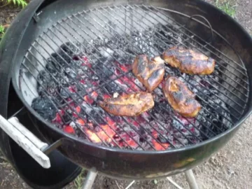

I use doug fir bark, which can be very thick, for barbeques. Makes very hot coals and leaves very little ash.

Douglas fir bark is very resinous and has a BTU/pound rating of nearly 10,000 which is actually more than the wood's rating of up to 9000. I'm not sure of the density, but it seems about as heavy as the wood, so it's BTU/cord would be pretty high as well. It can get really thick on big trees, so it's nice that it's not wasted space.
