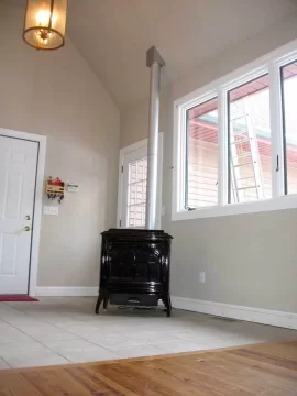

After Six months of back orders, arguments, pellet hoarding, pickup overloading, head scratching, and sawzall surgery I finally fired up my new Mt. Vernon today!
Couldn't have done it without a lot of info. from hearth.com
Here are some pics of my DIY install through the roof (nothing like crawling around on a steep roof in January!)
Anyway, it seems to be running great, but I am so paranoid I keep climbing a ladder and touching the radiation shield to see how hot it gets.
BTW I used the excel pipe and it seems very high quality.
I started to build a hearth pad months ago and then changed the location of the stove to the tile floor so I don't need it anymore.
If anyone wants to make me an offer, it is 3/4 ply with durock board on top. The sides are maple, miter cut and biscuit joined. 49X55. All it needs is your choice of tile on top. it would be a shame to waste.

How is your pipe temperature up near the ceiling? I bet your surprised at it's low temp? I think you will lose the paranoia quickly.

Rick, Couldn't you have vented that straight thru the wall?......I'm still a newbie.....Just curious....
Raven20,
I initially planned a direct vent, but decided against it because I have a small deck with a railing on the other side, not to mention horror stories I heard on this site.
Didn't want to go out and up because my house has a lot of angles and converging rooflines in that area. Plus, it would have looked pretty awful.
Actually, in hindsight, there was one positive thing about the infamous 6 month Quad back order. It gave me plenty of time to come up with the best plan. I am glad I went vertical, plus I actually like the way it looks.
codebum,
The box is warm to the touch where it enters the ceiling. I can keep my hand on it.
The pipe is hot, I can only touch it for a second or two.
Mine is vented thru the wall......The pipe gets hot but not the box.....I wouldn't be to concerned Rick....Just keep an eye on it...

Ahh, another temporarily happ Mt Vernon owner. Good luck. The AE isn't as advanced as they would like it to be. It's hit or miss. We take calls everyday about AE problems. Also, you rt rear clearance looks a bit close. Maybe its the angle of the pic but check your owner's manual. The clearances are NOT suggestions. Maybe even spring the 80 for a service call just to make sure you're on target. Happy Burning!

Nice looking stove and install, Rickster, although personally I would have painted the pipe black.

It's the angle of the photo.
I used a plumb and a laser level on everything.
I think you misunderstood me. That right rear corner looks to be close to the wall. The venting looks fine, it the positioning of the stove that concerns me.
Where's your hearth pad? 2 inch min. and you need 6 inches of side clearance. you may have that in the front but not the back. 12 inch tikle floor. Don't let your insuance company see that.
