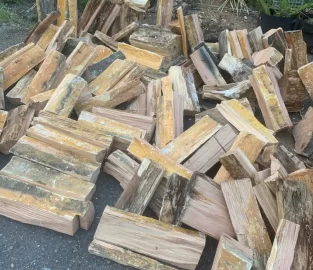

I bought some douglas fir and much of it is heavy with sap. Many pieces have thick layers of goopy yellow sap, and I'm worried about this leading to creosote buildup in my chimney and/or stove (Morso 5660 insert). It was supposed to be "clean and dry premium" firewood, but it's kind of a mess. It's been about 5 or 6 years since I've been able to find good firewood to buy, at any price.

I've burned a good amount of (not Doug but) fir with similar sap n what I think were windshake defects, (as well as pitch pine, which is worse....)
Not a problem if it's dry - and if you stack it now off the ground and top covered it'll likely be okay this coming winter.
You do have to be able to control the draft so it doesn't suck smoke past the reburn tubes too fast.

I do have experience with this problem. The pitch is an accelerant, might as well be diesel fuel. It will heat up and boil/bloom in your firebox and release all of that fuel in a short time. After that bloom burns off the wood itself will burn like usual. With the fir, the pitch is usually in a layer and not throughout the wood. That's why it is so visible. You could cut it off but that's a lot of work.
So during the bloom in this very fuel rich environment you can provide sufficient air which will combust most of this fuel bloom into immense heat or you can try and restrict air which will keep the firebox cooler but puke that raw fuel into your chimney leading to black smoke emissions and sooted chimney and firebox. If the flue temps are high, you are not likely to get gooey creosote accumulations but soot and stink. Even if you provide large amounts of air, which your noncat stove will do by design, you still will have a hard time combusting the fuel bloom, there's just so much. Since your noncat will dump air into the firebox you run the risk of a runaway stove getting too hot because more heat creates more draft which sucks in more oxygen which makes more heat, round and round until things run away.
I recommend not burning the fuel in that picture without diluting it with non pitchy wood. A chunk at a time might even be too much. Start very slowly. Pitch side into the ash.
I thought it would be fun to burn that pitch wood. More BTU! It was not. The pitch melts and boils and runs off and can splatter onto the glass. Even cat stoves have a hard time eating all of the fuel bloom. All of these stoves are designed to burn wood safely and cleanly, that thick layer of fatty pitch is not wood. When it was fresh cut green that layer of pitch was like crisco and gooey.
