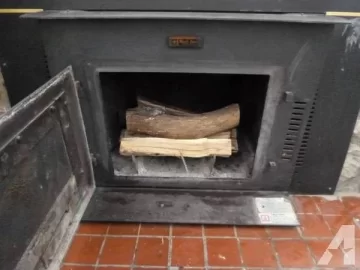

Post a pic of the inside of the stove and the grates you are using. I dont know the stove at all is this a grate over an ash pan of grates like you would use in a fireplace? if it is the latter just take them out and burn on the floor that is the way wood stoves are intended to be used.
Yes, use the grate only when you are burning coal. If you are burning on the stove floor, put down a couple inches of dry sand (play sand is fine) or a couple inches of ash to protect the floor.

One of these? What is the difference from a 3200 and II ? As far as I know, the grate is only for coal.

If there is no support on the bottom, I don't think it uses one. I would burn on a bed of ash anyway. Maybe fill in the bottom higher with firebrick (or fill with sand) to get the fire up to the air intake level at the doors. There are a few old threads about Black Barts, not many good. Use the search feature at top right.
[Hearth.com] Burning thru grates burning wood/coal This is the way I see them burned. Started raised to get going and crash down to complete burn.
If you let ash pile up to were it touches the bottom of them they will warp for sure.
