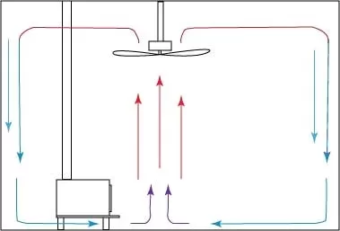

Many are suggesting to reverse the fan direction for more heat flow. What direction should the fan be turning? If you look up at the fan, should it be turning clockwise?
Reverse would be counter clockwise, fan should be blowing air at the ceiling.
In most cases, for draft free comfort and good heat circulation, the ceiling fan should be blowing upward in the winter.
  • [Hearth.com] burning too much wood!
