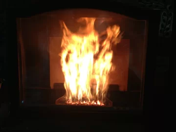

Was at newf lovers house, this was her p68 firing up for the upcoming season...stoves a bit oversized for the house so she creo's up in the late shoulder seasons from idling.

Would the creasote be from poor air flow? What config is the venting?
3 feet horizontal. It's cause the unit is oversized, just told you that
That is not a good installation, I bet 3 vertical feet on the inside of the house would work alot better. Also 4" diameter. I rebuilt a P61 that went straight out and it was not oversized and really creasoted up on the inside. Did you fail that install on your inspection sheet? ? ?

So it's oversized, so I'm guessing shes running automatic ignite / room temperature mode?
Would running the stove in manual prevent creosote build up?
I haven't experienced any yet, but just curious. I know my 68 is only running probably at 30-50% capacity @ 2-3 bags a day @ -40, it don't take long at full blast to heat the place up (I set back so I love it)

Newf lovers install is fine. There is no vertical but it's great and has an oak. The problem wasn't always a problem. Back when the house wasn't insulated the was no low temp burns going on. Now that they have a well insulated house running a P68, well the thing can heat the house on idle. Stove temp for a day burns it out. It's all good. No problems to report. And let's all try and get along. You guys will see a lot less of me coming soon so the don/scott threads will pitter away as real problems from forums newbies arrive.
You are right. Yes runny it a while on stove temp will clear it right up.
