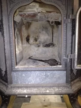

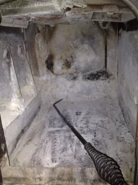

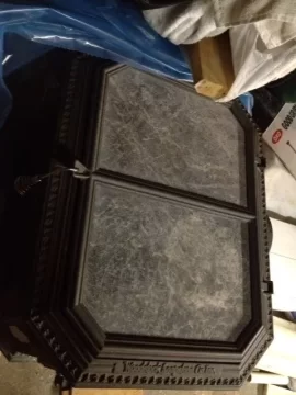

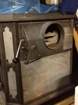

Here is images of fireview woodstove I might buy tomorrow does anybody sees cracks or visible problems? It all looks too dirty for me )))

Did you get any pics with the top up? So you cAn see the baffle, bypass, and cat assembly? Also the glass...if I were selling I'd for sure clean the glass! :)
In the 2nd and 3rd pics the baffle and cat look shot - but since I have a different fv I'd defer to others for opinions. My stove was 20 years old and I rebuilt with new baffle, cat and cat assembly, for about $200.

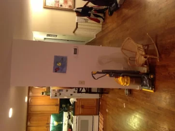

As you may see we have open space - living room, kitchen, dining atc - all in one open space layout. Please forgive a mess - 3 kids... One photo shows house wall from outside.
I was thinking to either
#1 place wood stove instead of piano (first image) this case it will be close to couch and will be center of "couch life". But chimney still have to rise above rooftop and this might be more complicated then second idea
#2 place it in the center of the wall, photo number 2, where messy boxes right now. This case it will heat more evenly and chimney will be centered outside (photo number 3) but there will be no "sit next to fireplace" unless i buy special char for that or something...

How about at the column when the vacuum and broom are? What is above this area?
Don't want to burst your bubble, but, with efficient stoves there will be no wood smell outside and inside you may get a little roll out when loading but that is it.

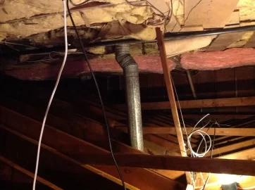

This is interesting, this column has pipes from gas space heaters to the roof. See pic #1 - above this column is attic and chimney pipe.
If it would be possible to connect to it i'd save a lot on chimney. Not sure if anybody did this though.
Column installation would be good in terms of "place heater in the center of the room" plus it would ideal if it would be possible to attach to existing chimney. Downside is what it is right in the middle of the room and existing the traffic.

Existing chimney is no good, you will need new/separate class A; just looking at central location as a good spot.
