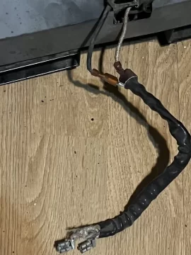

Hello! Can I just connect the black and white wire and have the fan run constantly unless I turn it off?Thanks in advance

Often yes. That's an odd thermocouple. Is this for a wood stove? What make & model?

Thanks for super speedy reply. It’s from a Vermont Castings Montpelier wood-burning inset, so yes it is older,. I don’t think pre-93 though so that’s I why I used this thread. The two plugs attach to the snap stat itself. Thanks again.

Turn off the fan when cold starting the stove for about 30 minutes so that the stove can warm up fully. I'd also turn off the blower when opening the stove door for a reload or log adjustment.

Yea I just connected black and white and it runs fine. Yep let it heat up for an hour or so and then turn it on. I’m in this mess bc I did not turn it off while reloading, a coal fell out, got sucked in and melted one of the wheels, and when I was removing the fan to fix it I broke the snap stat off. Will be turning off whe reloading! Thanks for all your advice.
