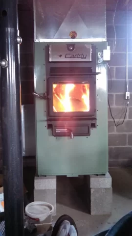

I'll try to post a (not current) picture:
[Hearth.com] Caddy Install
It's a fancy Euro one. I don't think it's really necessary. I would think an ordinary Field Controls baro should fit. I don't know why it wouldn't, but I'm no expert. Maybe Field Controls make several kind. They seem to sell them with collars, mostly? Maybe the R-C model can be removed from the collar and put into a 6" pipe. Why doesn't the one you got from HD fit.

  • [Hearth.com] Caddy Install
