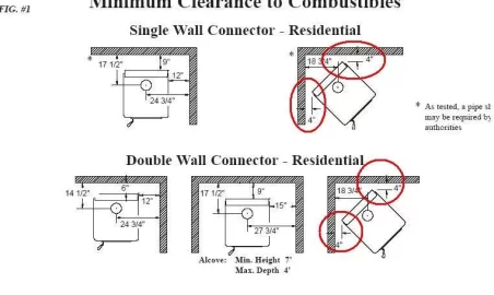

He is the clip out of the Summit manual . ( i added the red circles )
JFK said:
This is a direct replacement for the Avalon Pendelton stove, 6 inch pipe, single sided. I checked the clearance on the one side if I put in the Summit and it will be 8 inches. Checking the specs it says you need 4 inches, so I guess I am good?

with 8" corner clearance you will end up with you should be fine.
* On the back of the stove on a flat wall install going from double wall clearance of 6" to single wall to 9" is 3" and if your going to be at 8" on the corner install thats adding 4".

Another question If I did not need a pipe shield when I had my Pendleton installed and it passed code in my town, I should not need one for the Summit correct

Your current stove was single wall and passed inspection one would think it would be OK with the summit. Measure from the center of the singewall to the wall, what is it?
Measuring to the center of the two walls (where the two walls touch) that is 29 inches, measuring to the wall on the right side it is 19 inches, measuring on the left (where it touches the blinds) it is 20 inches.
So 29 inches from pipe straight back to wall, 19 inches to the right wall, 20 inches touching the blinds, this is a corner installation too (You probably already knew this.....)
What do you think? Am I good?
I'm not an inspector, but it sounds good to me. You are exceeding the MFG's 18" 3/4 requirements.
Your current stovepipe location may put you closer than 8" tho...center of my pipe to the wall is 21" and stove to wall is 7". So if you got 19" on one side I'd guess that would leave you about 5" not 8" (the min is 4")
JFK You sound good to go . All the #' look good ( unless Elker pulls something out of a hat )
