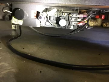

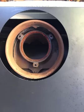

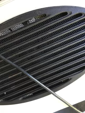

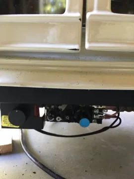

Hello,
I have a used propane stove and cannot find a model plate...just some numbers stamped on the doors. Searching those numbers brings up nothing. Any suggestions?

Pretty sure it's a Jotul. If you give the dimensions, I can confirm. If it is, it's a good little 26K BTU (input) stove.
(broken link removed to https://jotul.com/10739/jotul-gf-300-dv#technical-area)
Nah, that's a Stardance (130-1087 is the casting number for the control door). Not enough views of the unit and controls to tell if it is an old rear vent or perhaps a vent free model.

Wouldn’t a Stardance have Vermont Cadtings stamped somewhere on the stove? I can’t find any manufacturer info and it’s so frustrating!
Vermont castings. Look on the back.
A metal tag that attaches to a little metal hook on the back top right (if looking from the back). Could have been removed.
Serial plate was removed. Located the model by using part numbers. It’s an older rear vent Stardance model. The starter part for installation is expensive and hard to find. May not be worth the trouble for an older stove. Thank you everyone for your help!
