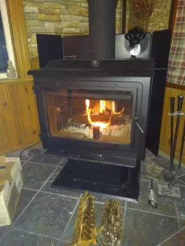

I ve had oversized stoves the last 12 seasons. With a well insulated home of sprayed walls, it was very economical to heat. Unfortunately, it was unbearable and hard to control the comfort in our living/TV area most of the heating seasons and our usage went down. This year we moved the stove, still oversized, to an adjoining unheated insulated porch and with the use of a sliding door and fans, have been able to keep the temp comfortable in living area, 70-77, and perfect in the bedrooms, 66-72. Im glad I kept the oversize stove, but wish I had chosen an ideal area for it years ago.
