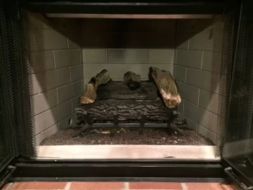

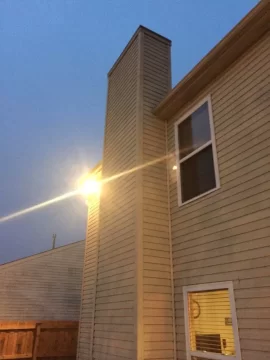

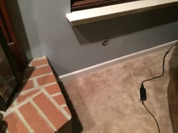

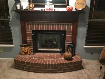

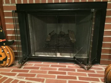

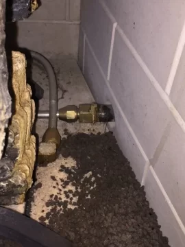

We moved into our current home last year. The fire place already had a gas log set in it. There is no blower, so I feel like every time I use the fireplace, I'm just tossing money up the flue. So, can someone tell me (based on attached pictures) if I can remove the gas logs, install a gas starter pipe, and burn wood in there instead. I do have a functional flue with a damper that needs to be open when the gas logs are burning. Any info is greatly appreciated.

It is hard to say, just based on the pictures, although they are very good pictures.
Why don't you find a good local wood stove installer/ chimney sweep to come out and give you an evaluation?

I wouldn't worry much about a gas starter pipe it is really easy to light up a fireplace, a few sticks of dry pine and some newspaper and you are up and running.
Of course if you can arrange a gas starter pipe so much the better.

It is a zero clearance fireplace very very few of them can have an insert installed in them. The fireplace manufacturer has to approve they type of install for it to meet code and very few do.

I see an external chimney, presumably masonry under the siding. I see what appears to be a refractory block firebox, and a nice big brick hearth.
Once you remove the doors and gas line, how is that different from an old fashioned masonry fireplace? Why would there be codes against putting a stove in there?

My understanding is a zero clearance fire place is a pre fab unit that requires no clearances because the outsides do not get hot to the touch. I'm guessing you always need to run a blower to get heat out of them. So adding a stove insert can overwhelm or over heat the fireplace structure ?? Just a guess

Oh almost forgot, that is not likely a masonry chimney it is likely a factory stainless pipe inside of a wood framed chimney chase. Hope that helps.
no it is just framing under there with an air cooled chimney
It is a sheet metal box with some refractory panels there are air channels around that box that circulate air to keep the outside cool
