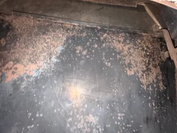

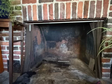

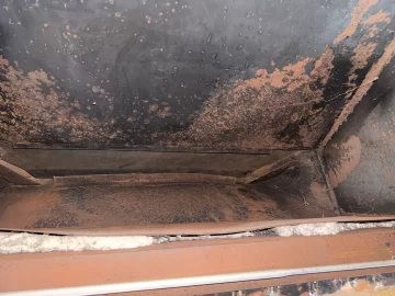

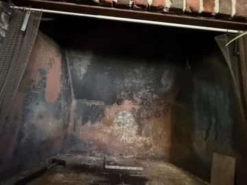

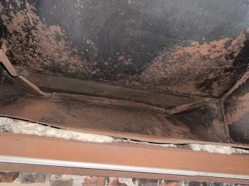

I recently moved into an old (late 1700s) house which has an old fireplace. From my research it seems to be a hetalator style with metal surrounding the firebox. I'd like to modify it so that I can I can install a wood stove with a chimney liner. It looks like I will have to do some cutting at a minimum to get the damper out. I'm looking for any guidance here, especially so I don't create myself a problem.
would it be best to just cut the damper out and use an oval liner or cut further down and use the full round liner? I attached some pictures which show the current setup. I can provide additional pictures if needed. Any advice is appreciated.
Thank you

If this is a properly installed heatform style fireplace, then it's ok to cut out a section to clear the round liner after the damper is removed.
There are several past threads on this type of installation. Search on "heatform" to bring them up.
Do insulate the liner for both performance and safety.

Hello, than you for the guidance. After a little work I was able to get the damper out without any cutting. It looks like it will provide me enough space now to get the liner through. I'll give it a shot and respond back with any new issues I run into.

Most need to be cut a bit regardless just to make things line up
