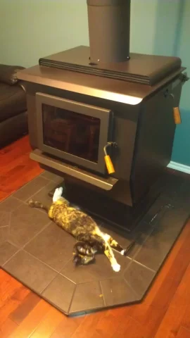

Just wondering if it is possible to remove the top on this King Ultra?
The part where the fans (if attached) would blow the air through.
I have no use for it (or do I?), and would like to know if it is possible first, before I start fiddling with it.
Or, is there another reason that it is there?
Thanks.

If you are running without the blower I don't see why not.
Nice looking tortoiseshell there.
Other than being welded on, I don't see why not. It's standard on the ultra, optional on parlor and classic.

As for the stove, I just had a closer look. It looks as though there are only 4 screws holding it on. I will have to wait until the stove cools down (maybe next spring) remove the side plates and the flu. Then, looks like it will come right off.

WIth the princess, it is an option on the ultra and an extra cost. It just sets there. It's called a convection deck and routes the blown air across the stove top to pick up more heat before being blown into the room. This is a good thing.
If yours is not welded on then you should be able to move it around on the stove top. If it is welded on then I would leave it alone.
It came on the stove when I purchased it. Didn't really want it on there, but, never thought to remove it. I never plan on putting the fans on, so, for now, it is just a decoration. I have enough air circulation in the room, and through out the house, that I do not need the fans.
Sure you can remove it. It just has 4 screws that attach from the bottom.
What is the reason for removing it? It would allow you to cook on it, but it won't heat any differently.
No, I know it won't heat any more, but, my wife wants to put a pot of water on there, and, it will barely heat on the convection deck (thanks Highbeam), plus, I noticed that it is a dust trap under there.

Thanks Highbeam, yes, I did get my answer. No, not welded on. So, I just have to wait for the stove to cool down, then four screws and removal of the flu, and it should come off. I may have to get the railings though, because there will be 4 screw holes on the top of the stove once the deck is removed.
