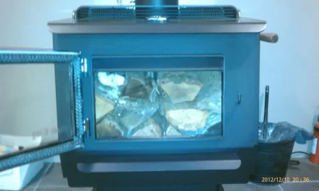

Can I remove this?
typically best to ask the maker of the product if you want to modify it...do you need their phone number?
the convection deck is not optional equipment for the king ultra.
bk told me it was due to heat dispersion off the top of the unit vs ceiling height. (ceiling must have gotten too hot in lab tests!)
if your ceiling is taller than normal and you are not in an alcove, it should be safe.

  • [Hearth.com] Can I remove this?
