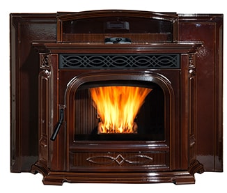

Something like this..
OK appreciate the feedback ........ I have been looking at that exact stove. Still on the fence .... nice thing about gas, it's always there I get natural gas right off the line from the street, unlimited supply (theoretically), needs no electricity to run. I just wish they weren't so damn uninspiring to look at - ontop of that the actual act of burning wood, the smells the heat, you cant argue the heat is better when burning a wood product. I've been considering just replacing with a newer more efficient gas stove but in the last three houses I've owned I've had wood burners in all of em either a pellet stove or a wood stove .......... gimme wood and fire.
