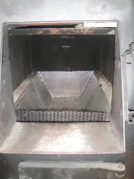

Ok here is the pic of my home made pellet basket.....
  • Can I use pellets in my Wood Stove

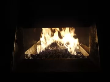

Burn Baby burn!!!
Once I close the door it roars

I filled and started it at noon EST. It's 1:30 now, Let's see how long before having to add more pellets.
Oh and I made a mistake, the basket I made holds about 3/4 bag of pellets.
I believe the pellet basket the pellet basket will work on stoves that have a good bottom draft. I'm not using my bottom blower ( blower not on) but I have an air intake adjustment on the blower to let the air in though the bottom.
