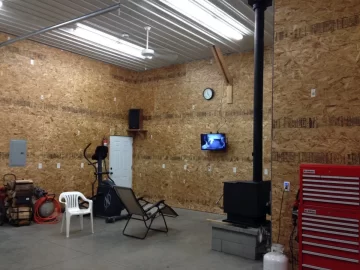

In my shop I have the front half of the lights on one switch and one circuit, then a separate circuit and switch for the back half.
Oh and I love how the light bounces off of the white metal ceiling.
