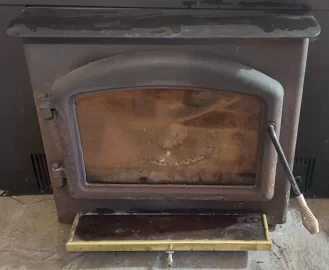

Can somone please identify my stove insert?

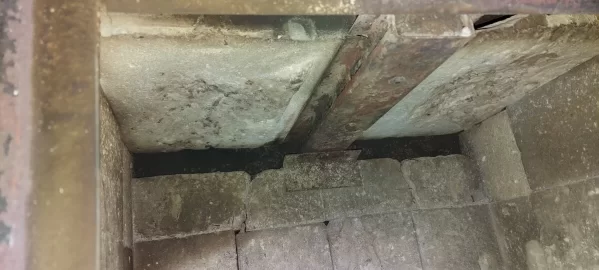

Can you post a couple of pictures of the inside of the stove with one of them showing the baffle area?

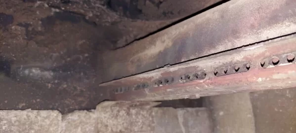

Does it have secondary tubes under the baffle? Or does that channel have the secondary in it running front to back?
If it has a center secondary tube that runs parallel to sides I'm thinking it's a Napoleon 1101.
Reactions: Kevin Michigan
Hello yes, Thanks, I think that's it. Now I just need to verify if it's a Oakdale™ EPI 1101 OR 1402 wood insert. I need to order fire brick and baffels.

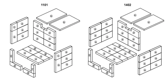

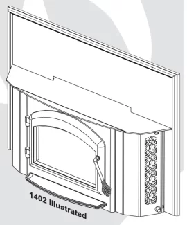

It looks like it's the 1101. The 1402 has side wings like the illustration.
[Hearth.com] Can somone please identify my stove insert?
The 1101 is more of an E/W loader. The square firebox in the 1402 can be loaded N/S.
