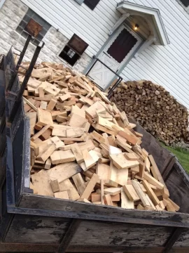

I use a combination of splits and kiln dried oak ends from a local hardwoods products manufacturer (photo below). The kiln dried wood has a moisture content of 6-8%. It burns great, but extremely hot. It would be easy to over fire the stove using only the kiln dried wood.

Okay - I am gonna jump in...
Will air dried cord wood get too dry? Probably not.
Can wood be TOO dry for an EPA stove? YES.
The problem that arises from TOO dry of wood (say kiln dried lumber) is that the wood can actually outgas FASTER than the stoves reburn system can consume them - a dirty burn. Believe it or not - it is possible to get incomplete combustion from wood that is too dry. And we all know about the overfire possibility.

you should be fine, but if you were to pack that stove full of those thin pieces, you may get some high temps, and have a hard time cutting it down....
