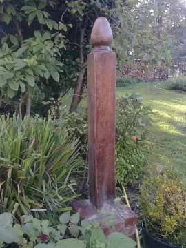

    Hi, I did manage to save an old stair post, solid oak, to nice to burn so I put it in the garden as a sort of feature -

    Awesome. Some great conversations around that, I bet.
