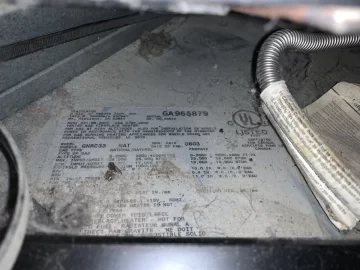

Just purchased our first home, there is an Heatilator GNRC33 Gas fireplace, which for the life of me, I cannot figure out how to get the main ignition going.
I have the pilot light on, however this wall switch is something I've never seen. I've attached images. (Hard to see, but there is a small black lever that goes in 3 places, OFF, REMOTE, and ON)
The previous homeowner said they would just switch it to on, and it would work, but alas, not the case for me.
The box that pops out has 4 AA batteries, which I've replaced.
Apparently there is a remote control system for this as well, but I really don't care about that, just wanting to manually get it on.
Any thoughts?

Let's see if the fire place is the culprit or the switch.
In the first pic, I can't see if the On-Pilot-Off knob is in the ON position.
Make sure it is ON.
There are two wires attached to the right side of the Gas valve with female Spade connectors.
Take a small piece of wire, or a paper clip or something metallic & "jump" those two terminals.
Does the unit fire up?

Thanks for the reply, yes the knob is set to ON. Sorry for the ameatur question, this is my first fireplace, where exactly would I be placing the paperclip to 'jumpstart' the terminals?
Look to the right side of the gas valve.
There are 4 wires attached.
Two are held by screws.
Two are on Spade connections.
Jump the Spade connections.
