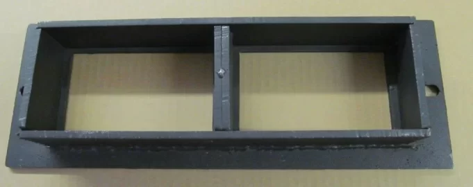

I called total hearth today they were extremely helpful! Joann was nice enough to get the part and measure the gap between the holes on it for mounting and it is greater than 13 inches. She even offered to send me a picture of the part which i have included in this post. unfortunately i don't think it will work it is advertised as being for the 7000 and 8000 so i would imagine that my stove takes round cats. all of the holders i have found are rectangular. is my thinking right or is there another part that mounts this holder that i am also missing?

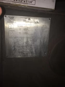

There should be a UL label on the stove. Look on the sides or back for it. If you find it, take a good sharp picture and post it here.
I believe that this is what it is it is tested in 1985 so that would make it at least a 1985 but what does that mean for round vs square cats.

Hard to see but is there a model variation listed at the top center?

I contacted them and they sell a holder however I'm not sure if it will work or not. They were very helpful but no answers on much besides being helpful with the product they did have. The measurements on the holder that they have for the 8000 and 7000 are...
Here are some measurements:
It is 14 ½” between the middle of the holes
16 ½” overall length
13 ½” from end to end of the catalytic holder
I will measure the stove again to make sure this one won't work.
