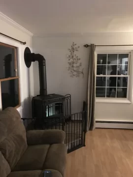

recently bought a hearthstone shelbourne got it installed a week ago...... been trying to get it started but im just having a hard time getting it hot enough to put off real heat.
I get the intial fire with newspaper kindling and a few pieces of fat wood going just fine and then I add some small pieces of wood fire takes off nicely .
Problem begins when i start adding logs .
The wood is seasoned on average 16-17%
I have the air intake open and notice i also have to keep the door open otherwise it dies out or just dosent get hot enough...... the hotest its got is 450 degrees.
The wood just smolders in some cases.
If i add too many pieces it smothers the fire
Even when the fire gets going its not hot enough

How are you measuing moisture content?
Reactions: Dix
Also how is it installed? How tall is the chimney?
2 feet to 90 elbow out the wall chimney outside is probably 24 feet

Are you splitting the wood right before you test it? To get the proper reading you have to test the middle of the wood, not the outside.
well I received a shipment of two cords that was already split and when I tested I tested on the ends and the majority of them gives me a reading of 15 to 17%
You need to re-split & test on freshly split surface, for an accurate number.
I would split it into and check the interior

Also test at room temp, testing the ends will not give an accurate temp. If its 15-17% on ends the middle going to be higher.

Your wood is not ready to burn, unfortunately it is very rare to buy wood that is ready to burn, while every dealer tells you that the wood is seasoned, chances are it is not. Looking on the bright side, you now have 2 cords of wood for next winter as this wood should be ready to burn by then.

Hey USMC1775, nice looking setup.
As you strike me as the type of guy who appreciates straight shooting, your wood has too much moisture in it and you've been reading the meter wrong.
There are hundreds if not thousands of similar posts on this exact situation on this site, so just do some reading, and you'll see countless variations of the responses you've received, many from the same folks who have responded to your query. You'll figure it out, just do some homework reading through other folks past posts on the topic. Not ideal for this year, but you'll get lots of suggestions on how to improvise as you read.
